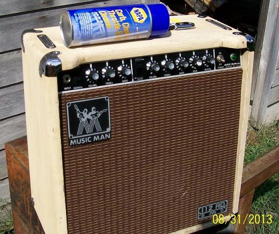

This is an Amp that was painted and I used carberator cleaner/throttle body cleaner to get paint off. Spray on paint, it will run, wipe with paper towel. If you wait too long, the paint will set back up. I have used 4 cans to get it this far. Also changed the grill cloth as the old black cloth was ripped up.

Wow - those results are amazing - it looks really nice.

I just noticed - your amp has a green power on indicator - cool!
