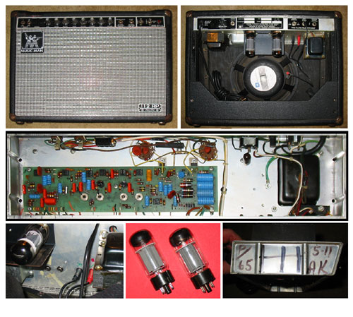

I got this 112RP 65 in a trade over ten years ago. I traded a Plush cabinet with four JBL 12's I bought for $150. I've pretty much been pluggin' in and playing it since I got it. The reverb tank was gone so I had a tech install a used one for $40. When I picked it up all he said was it wasn't a "true" tube amp in sort of demeaning tone. So my total investment was $190.
I'm just looking for as much feedback as I can get from others with the same amp (or who know about the amp). I have never changed the power tubes but it's missing the tube protection board on the back so I assume someone may have changed them at some point. It has two 6L6GC tubes, not marked with a brand name but have Made in USA molded into the plastic base. The chassis circuit board has a handwritten marking "Pat 5-11-79".
I like a clean sound sometimes and dirty other times so by using a Tube Works tube driver preamp along with a tube screamer I can get a variety of sounds. I experienced a mysterious "crackle" after about three hours of playing my last two sessions. It could be something simple or a bad omen. I took the front end effects out of the loop and still heard the noise. There didn't seem to be a major loss of power or anything. The amp does not hum or make other noises. I was going to start with simple stuff by going at the pots with tuner cleaner from the inside. I'd think a speaker problem would be an all the time noise not something that happens after it gets hot.
ANY info you can give me will be appreciated.

Hey LastnoteJonny could you do me a favor? Would you check the number on your reverb tank and post it for me? I have the same amp as you and some one replaced the tank with one for a marshal.Man talk about tone, these amps never got the recognition they deserve.Thanks for the great pictures of your amp.

You might have something as simple as dirty tubes sockets. These amp are getting old you know. A little Deoxit in the socket and move it in and out should do the trick. Also, a retensioning of the sockets themselves sometimes does wonders. Mike.

I haven't done a thing except play the amp for over ten years. I'll clean all the pots, tube sockets, etc. and try your tip about retensioning the sockets. Thanks Mike.
You got any clue if these would be the original tubes from looking at them? I feel pretty sure this amp is supposed to have the 6L6GC's that are in it (also coz it's a '79). I was looking at Tesla (JJ) tubes, JAN Phillips or SED. Anyone who has the same amp have an opinion?

In the Model chart on this site, it has for a 79 Music Man 112-65-rp-RP it is showing (2) 6CA7 tubes...?Mine is an 84 112-65-RP and it has the 6L6GC tubes. Might want to see if Steve or Michael might be able to guide you to the right ones.

In previous correspondence with Steve he said, "If you look at the schematic set, it indicates that the GD-1 circuit used 6CA7 tubes, while the GD-2 and GD-2a circuits used 6L6. If you could find one of these circuit numbers on the inside circuit board or otherwise identify the circuit from the schematics, then you would know for sure which tube was stock."
There are no numbers on the board I can find. Anyone able to tell from my pic of the circuit board? I can enlarge the pic if necessary. I've downloaded the schematics and will try to figure it out. I have a BA in graphic design not eletrical engineering so it's all new to me.
By the way SS, my reverb tank says "Accutronics, Geneva. Ill, Pat. #'s 2,982,819 and 3,106,610, 4FH2B1A."

I took mine apart to put 2 10 inch speakers in and clean it out. I checked the circut board and all I could find is a date 9/11/81. And it looks a lot different than yours in a lot of ways. on the side plate mine reads P/65 6-16 FP. You might post under a different topic on here for help also. Good luck, and thanks for your help on my proublem.

Hey Mike, I cleaned it all up all the way down to removing the knobs and scrubbing 30+ years of grime away. My gain pot was working up to 4 then wouldn't change until it hit 10. Now it has a smooth transition but still makes a bit of a jump between 8 and 9. I may still need to replace the pot but it's better than it was. I powered it up and shut off the lights and found my problem: one of the power tubes is glowing blue on one section, the other tube is glowing orange. I saw in another post that a blue glow is a bad thing so I'm retubing with 6L6GC's from JJ/Tesla...unless someone else has a better suggestion. I decided on those tubes after checking eurotubes and thetubestore. The biasing instructions in the forum seem pretty clear. I'm just not real sure what NOT to touch in there. Having had a gas grill blow me up a few years ago and spending a week in intensive care at a burn unit, I don't take too well to getting fried.
