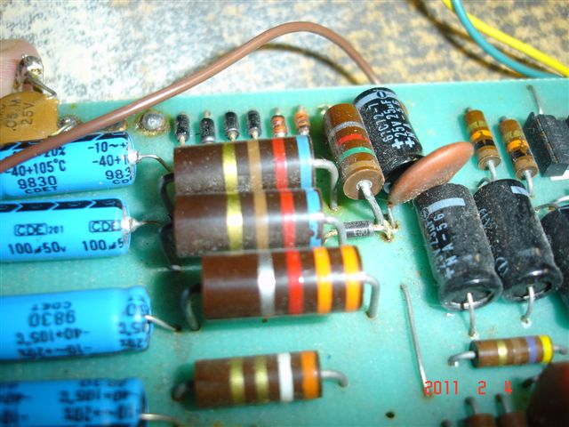

Turned on the amp this morning and took a reading across the 3.9 resistors and read zero volts. This is with the bias pot fully clockwise. I started turning the bias pot ccw and suddenly the voltage jumped to 350 mV. I am using EL34s, purchased a new output xfmr; sticker on the top says 5-75/9960449. There is a 1.5 ohm resistor between the tubes. Wife has my camera so I can't take a picture until this evening. Thanks! |
Duane Pfeiffer
| Posted on Saturday, February 05, 2011 - 03:03 pm: | |
here's a picture http://www.volume4u.com/images/001.jpg http://www.volume4u.com/images/004.jpg |

After looking at the picture....it looks like the driver transistors they say 2N4292 and they should be 2N6488. I know that on some of the schramatics they give you 2N6292 , but use 2N6488. Also the two capacitors that are to the left of the bias pot look to be in backwards. Check to make sure you have them in right. What is the yellow capacitor in the lower right corner by the screw going to? It also appears that the power tube socket on the left you have a diode, but none on the right. If that is the case, take the one out on the left, you don't need them. They were only there in case you had a short that it would go to ground. But most are no good, so just take them out. Send me a bigger picture of the tube sockets and that area of the board. Send it to my e-mail address if you want or post it here. And yes, Lars, if you have the 1.5k resistor, then the amp uses 6CA7 tubes. Because some of these amps have 6L6 tubes. So that is the best way to check. |
Duane Pfeiffer
| Posted on Saturday, February 05, 2011 - 07:40 pm: | |
Lars, I've replaced the four 470ohm bias resistors already. The voltage on the wiper of the bias pot goes from .6 to 1.2 as I turn the pot ccw. Terry,I had 2N6488s in there and I changed them to 2N6292 just to see if things would work better. I don't think it makes much difference but I'll put the 2N6488s back in. The two 22uf caps to the left are installed with the negative end towards the op amp. My CP-1 schematic shows them that way. My CP-2 schematic shows them as non-polarized. ?? |
Terry Loose (terry)
Username: terry
| Posted on Saturday, February 05, 2011 - 09:02 pm: | |
Turn the 22UF caps around. look at the pic I put up on bad repairs the caps are turned. |
Duane Pfeiffer
| Posted on Sunday, February 06, 2011 - 03:55 pm: | |
THE AMP IS FIXED! YAHOO! You guys are awesome! It was the two caps that were installed backwards. Thankyou, thankyou, thankyou! |
