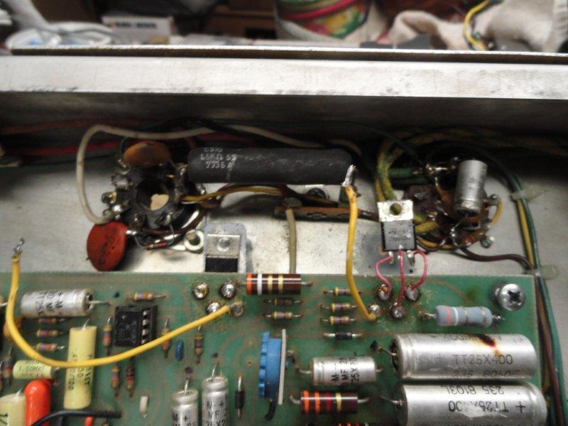

| Posted on Monday, January 31, 2011 - 06:58 pm: | |
This is a bad cap job on a HD65 that was done by a professional in Savannah. And the day after he did it, he quit the shop. They sent the amp to me to get repaired because it was used by a professional player in Savannah that said that it sounded worse then when he took it in. So if you get anything like this...don't accept it. Make them use the correct caps, because this does not work. |

| Posted on Monday, January 31, 2011 - 08:10 pm: | |
This is a better Pic |

| Posted on Monday, January 31, 2011 - 08:33 pm: | |
When you think you are an amp repair guy, this is how you save on parts and the customer won't know the difference when you tell them it is repaired. HD65 |

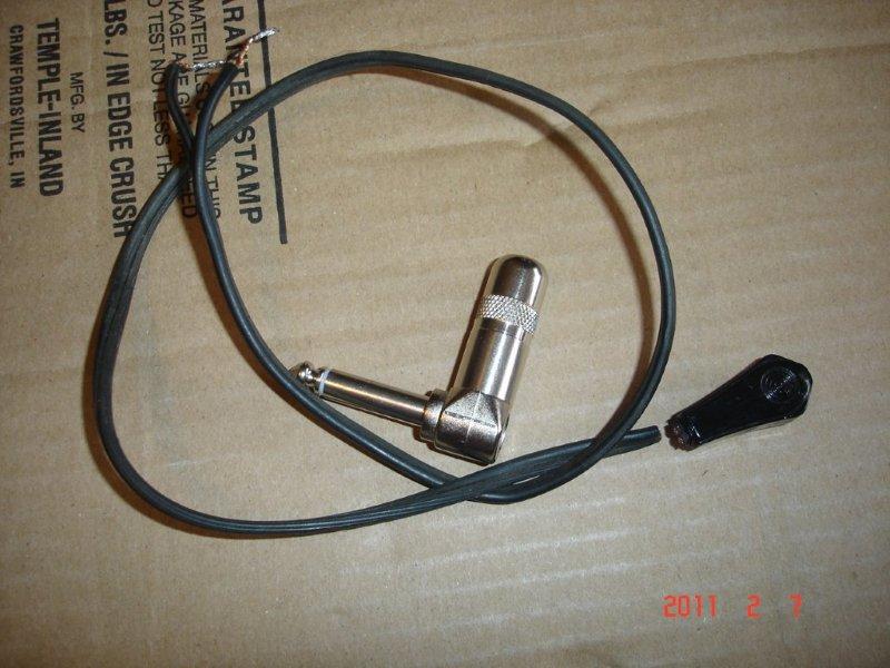

| Posted on Monday, February 07, 2011 - 08:12 pm: | |
If you have a original cord for your combo amp with the black plastic end, check it with a ohm meter to see if it is bad. A lot of them are. The amp maybe breaking up or you may think the speaker is bad, just cut the old end off and put a new one on! |
| Posted on Tuesday, February 08, 2011 - 03:24 pm: | |
All very good points of interest, although I will say, in an emergency(usually my own!), I have been known to piggyback a cap or two. Usually, I'm out of something, the amp took a dump, and I NEED it tonight. The flying components-NO excuse for that. That's just butchery. I have also seen the combo cords go bad. I usually just hrow the things away anyway and make a new one. I don't usually do restore type stuff so my stuff is done with reliability in mind. I keep hunks of old hair dryer cord around for combo amps. I know, it sounds hoosier but it's great, heavy cord and it's free, since they break all the time. I even like the curly ones! |

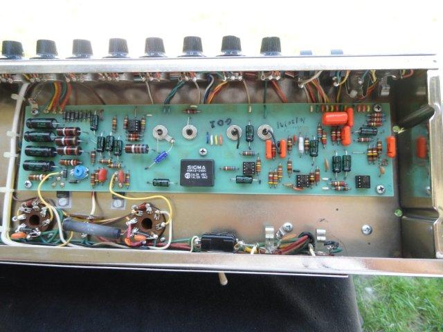

| Posted on Saturday, June 30, 2012 - 03:00 pm: | |
This is a relay on a GD1 board 1978 I have only sean two of these and one was missing the cover. Sigma- #60RE2-24DC |

| Posted on Tuesday, September 04, 2012 - 03:34 pm: | |
Thanks for that bit of info Terry! I owned (from new) 112RD-65 from 1978 that had the GD-1 circuit so this is close to my heart! There was something reassuring about that relay "click" every time the button was pressed. I never had a problem with mine in the 4-years of heavy use I gave it. It was still working fine when I sold it (but I wish I still had it). Steve |
