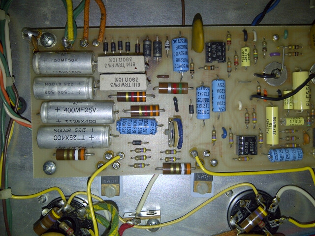

I have been dutifully reading the posts here to find out more about my (new to me) amp. I am a hobbiest, and enjoy tinkering with music equipment, but was unfamilliar with MM designs. I finally opened it up last night to verify the need to change components in the HV power supply section, but was surprised to find the low voltage section was the problem. Enough heat had been generated with the 390 ohm 3W resistors, that one was loose in the circuit board, as was one of the 5W diodes. I still plan to change caps, and diodes on the HV side, but will also have to rebuild the low voltage filter section as well. Another interesting design feature was the TO-220 transistors heat sinked to the aluminum chassis. I've seen that on newer SS amps, but when this amp was built, most others were installing dedicated heat sinks. |

Bill, After reading your post, I took a look at the board in my 112RD-100. The circuit is GD-2A (May 1981) The 390 ohm resistors and adjacent diode have a dark discolouration on the board. Is this what you saw on your 115RD-100?

It looked exactly like that, Lars, one of the resistors, and one of the zeners were unsoldered from the board. While I was there, I replaced the caps, and 1N4003 diodes, as well as the 390 ohm resistors, and the 16V zeners. Thanks also for the source tip, I have decided to replace the diodes with R3000 like used in Fender. They are rated 3KV, 250ma. I don't think I will need to worry about it at the volume levels I'll be using the amp. |

Thanks Bill, What does this section of the circuit do? What are the symptoms of this overheated section? Is it necessary to repair? |

Rob, most of the components there are the LV power supply/filters. Look at the schematic, and you will see the section as it connects. At the burned point itself, is the 16V zeners, and the (voltage dropping?) resistors. I didn't check the components I replaced in mine, I just considered it maintainence. |

Thanks again Bill. This is some more information I got from my Amp Technician. In the photo that you have supplied in the attachment on the low voltage supply components, there is some heat stress around the 5 watt resistors, 390 ohm, and the 5 watt zeners ( 1N5353 ). This is a common problem in any guitar amplifier +/- 16V low voltage design due to the make up of the circuit. These supplies all the OpAmp’s in the amplifier and switching transistors plus any other circuit criteria that uses this supply in the amplifier circuitry. This is caused by steady currents and fluctuating currents during amp operation. Over time this will cause the components that you mention to heat over it’s maximum design levels, this is normal. You can’t get around this unless you redesign the power supply include the low voltage tap from the transformer or change the doublers design if there is one. We see this all the time and what we do here is to remove the whole board and redo the traces and solder mask on the P.C.B. other wise you will eventually have a decline in the voltage of the supply and will cause circuit problems. The Resistors and the Zeners should be lifted off the board a few mm. so it doesn’t heat the P.C.Board this will help to prevent heat stress and solder degradation. This is a bit labor intensive to do, with no parts you are looking at about $70.00 labor or maybe a bit less, with parts approx. 75-80 dollars plus tax. Like I said this board will have to be removed from the chassis so we can work on it. The TLE2072 is basically a good chip for low noise floor and for impedance purposes, the maximum +/- voltage is 19 volts swing and on a 12 or 16 volt supply you would be better to go back to the TL072 or try the low noise TLC272APC same spec’s but better noise floor. They both have a higher voltage swing for distortion purposes. |

Rob, I did raise the wirewound resistors a little higher from the board when I replaced them. The Fender Hot Rod series amps are notorious for burning the circuit board, and in later generations, raising the resistors higher seems to help prolong their life. |
