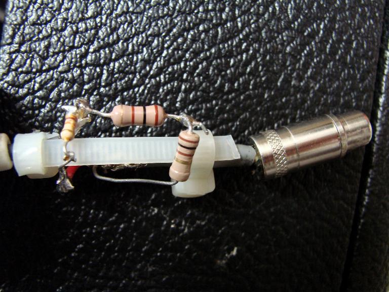

I followed Ed Goforth's advice and installed a MOD 8BB3D1B long delay reverb tank in my MM RD50. It works much better with no hum, strong output, and more like the old Fender reverbs. I had to experiment and install a 45 dB L-pad to attenuate the return so the Reverb control would operate at "5" mid range on the knob. I mounted the passive pad in an old film canister.

| Posted on Saturday, May 18, 2013 - 08:09 pm: | |
The L-Pad should be plugged underneath the chassis in the return RCA jack. That way the signal stays strong until reaching the chassis thus less chance of picking up stray hum and noise. |
