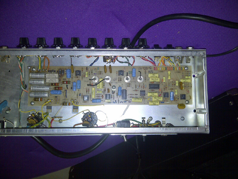

Note to all Forum members...Take a picture before pulling the ICs! It is hard to recall the correct orientation once they have been pulled and left on the bench for a while. I'll Post my own photos later. Pulling the ICs and swapping them didn't seem to solve the hiss issue on the reverb. But it did, however, give me a few heart paplitations when the amp didn't work when the IC is oriented the wrong way. |

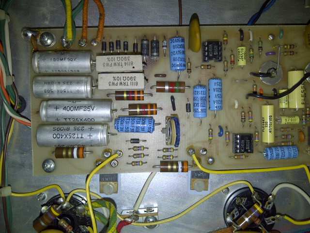

After pulling the ICs and swapping them around, I found no clear resolution ot the Hiss when the Reverb is engaged. What I did find was that there is a small Poteniometer mounted on the PCB that can be adjusted. Turning it all the way Counter-clockwise eliminated the hiss, but also badly affected the volume on the amp (decreased volume) and created distortion. Round vertical device in the centre of the image.
As a result I put the POT back into the position I found it, and put the chassis back together. Does anyone know what the purpose of the small POT is? Is a bias adjustment on the output tubes? Why does it affect the Reverb? |

| Posted on Tuesday, January 08, 2013 - 06:15 pm: | |
Tha should be the driver pot on that amp. I am not too familiar with the rd's but they only show ONE trimpot on the schem so that has to be it. Lower and it goes into crossover distortion and higher brings up the drive into the power tubes. You have to balance the pot to get the right setting and see if the driver transistors are balanced into the power tubes. THAT'S where a scope wouold be nice to see the waveform being injected into the finals. Mike. |
